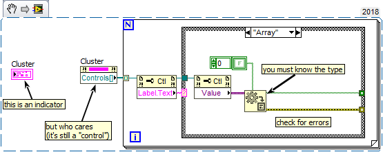

I believe something like this is what was suggested:

It's always the same approach: read the value as variant, then convert to specific datatype - as you already do for "DPS1_J4":
(Replace the string constant by a control. No error handling included…)

You need to make a seperate case for each datatype. Here's one possibility.
(Or course there are probably better ways since the labels cannot change at runtime. It seems like a nightmare to keep track of all these names and make necessary downstream changes if the next programmer decides the rename one of the cluster elements)
