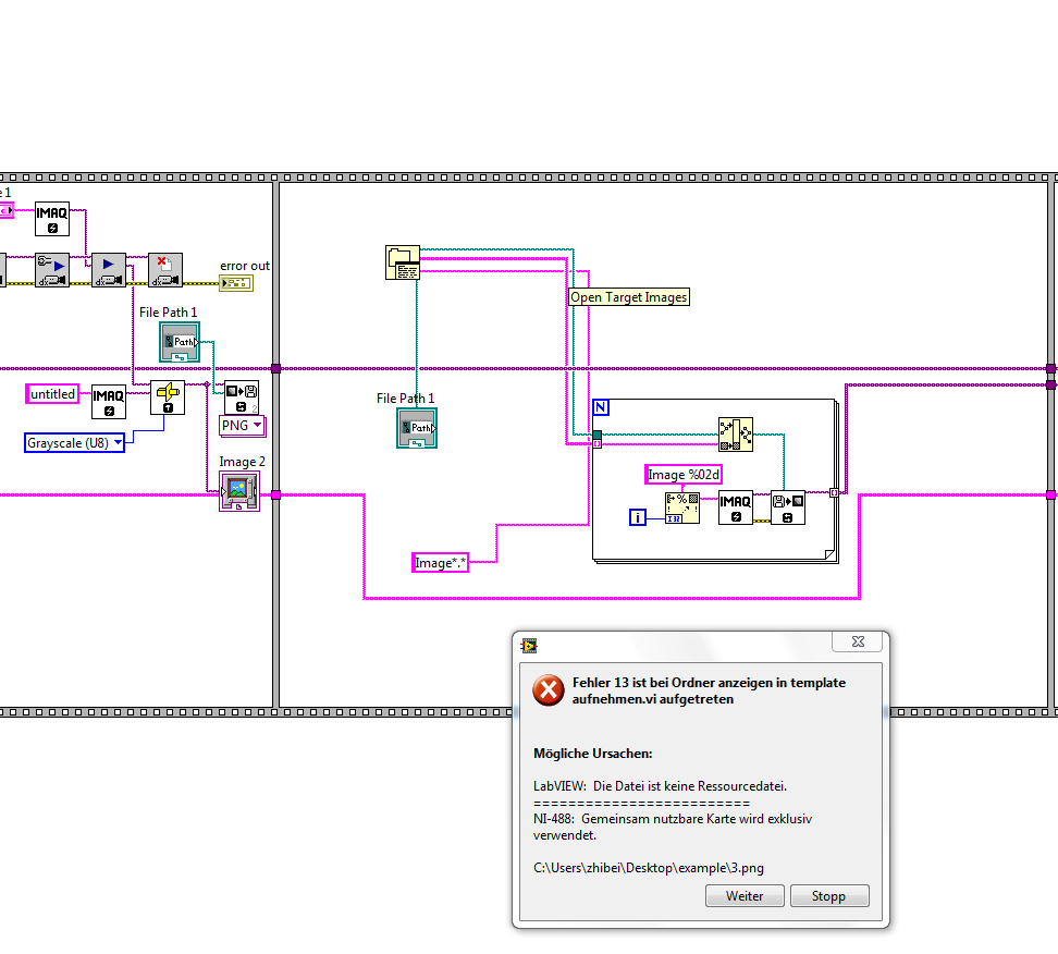

Im trying to imitate the "Match Multiple Gemometric Patterns Example.vi" to find out the matches object. But i have a problem which i can not solve jet. It says "The file is not a resource file".

Error 13 results from selecting a file instead of a folder in the Control: "File Path 1".
The default behavior of a File Path Control allows only files to be selected.
To change this behavior, open the Context Menu on the File Path Control (Frontpanel) and select "Browse Options..."
In the section "Selection Mode" check "Folders" and "Existing"
I hope this helps
