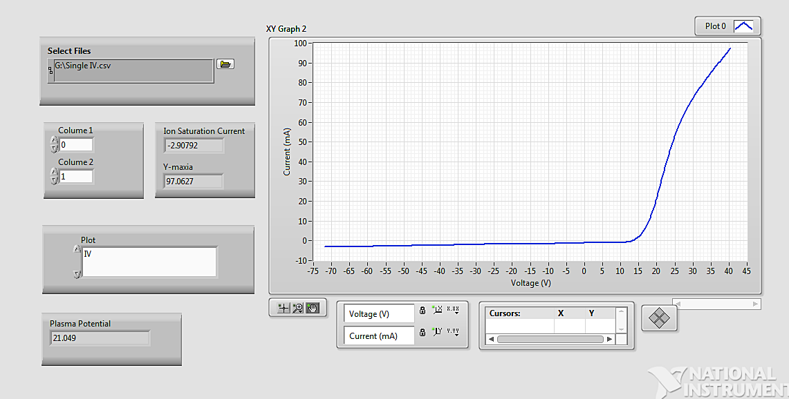

Hi altenbach,
here I am sending the snapshot of the front panel of my program along with the data and the vi.
(4,250 Views)
Try something like this....
(again, this assumes that the Y array is nondescending. If you have noise, you need better tools. There are altrernative versions that operate on the xy cluster array directly)
