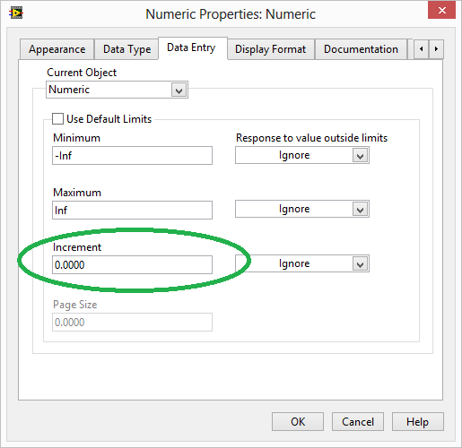

Set the increment to the difference between the upper limit and the lower limit.
Craig H. | CLA CTA CLED | Applications Engineer | NI Employee 2012-2023
