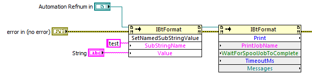

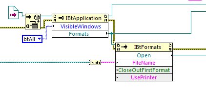

Since you started a duplicate thread - I'm going to continue in here.
We have given you a number of different options to generate/print a barcode using LabVIEW.
Do you have the Bartender software installed with the Automation (ActiveX) option? Can you print a label from within the Bartender Software? Do you know how to call ActiveX functions in LabVIEW? For the latter, if you Google 'calling ActiveX LabVIEW' you will get a lot of results. Once you know how to do that, you just need to know which Bartender ActiveX functions to call.
I've attached a couple of screenshots from some quick code my colleague put together before to initialise Bartender, open a label template, fill in a field and print a label. Don't forget the close the references when your application exits. For more information you'll need to read the Bartender documentation.
(blog)
Message 8 of 17
(9,919 Views)
