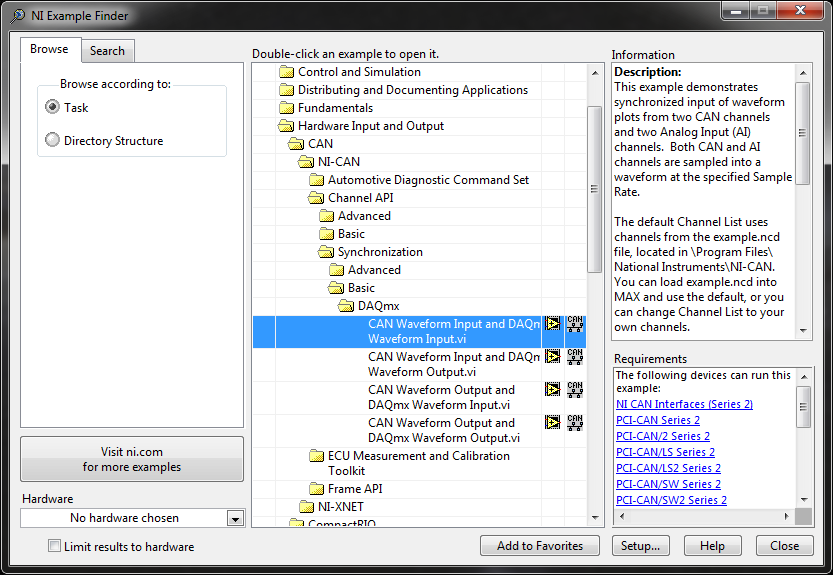

There is a good example that I think will get you most of the way there.  It is under a lot of folders in the example finder so I figured I would just post a picture of where I found it.
This example shows how to sync your CAN device with 1 DAQ device, but you should be able to use channel expansion to sync your CAN hardware to 2 DAQ devices.  If you are still having trouble, can you post the code you tried and tell us exactly what DAQ hardware you are using?
