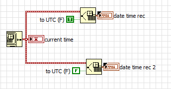

Try this
Notice the date time rec set to UTC has removed DST

Thanks. But I want to get to a UTC timestamp -- not a time record.  In my testing (by adding 60 second intervals inside a while loop) converting from a time record using Date/Time in Seconds did not resolve the daylight savings transition artifacts regardless of whether I set "is UTC" to T or F.

You mean like this?
