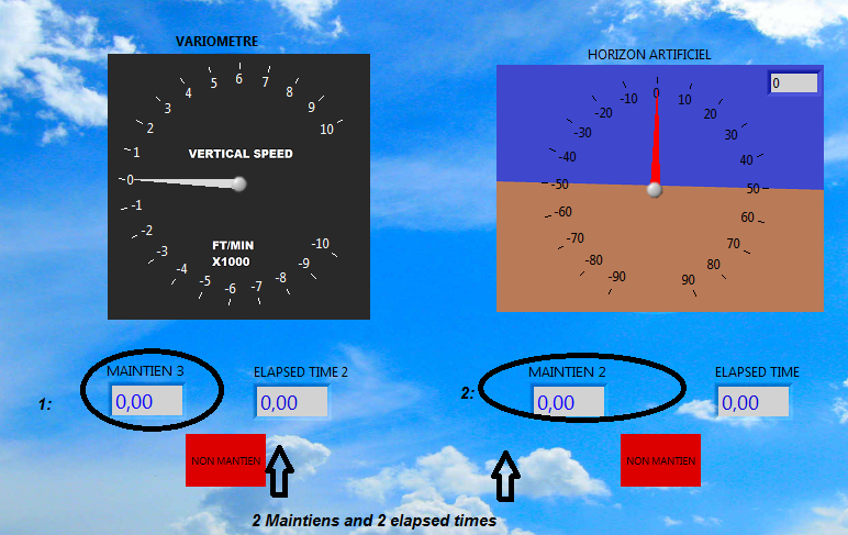

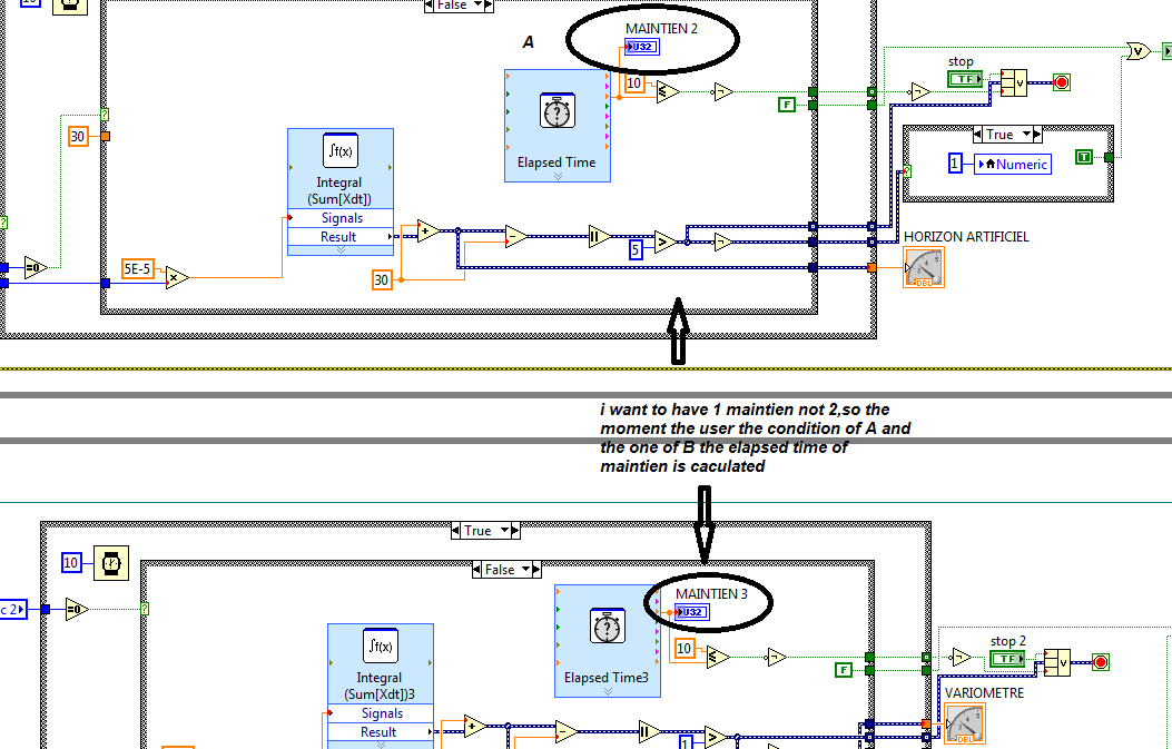

I'm calculating the time spent to maintain a value "elapsed time" for 2 things(A and B) differents,what to change in order to have 1 "elapsed time" not 2 ,so the value of "elapsed time" is caculated the moment the user maintain the value of A and B1.png

If you just want to update "MAINTIEN 2" in both cases (A and B) you can use a local variable for MAINTIEN 2 in the B case and write to that.

Elapsed time 2 is calculated when the user starts the test of "variometre",maintien 3 when the user keeps the pointer of the variometre in 7 for 10 seconds
Elapsed time  is calculated when the user starts the test of"horizon artificiel",maintien 2 when the user keeps the pointer of the horizon in 30 for 10 seconds.
that's good if i wanna each test alone,but now the complication of this one is to maintain the 2 values 7 of the variometre and 30 of the horizon in the same time during 10 secs.that's why i want to have just 1 elapsed time and 1 maintien,because the the 2 tests will run on parallel then the elapsed time must start and when the user realises the 2 conditions in the same time,the maintien must begin counting.

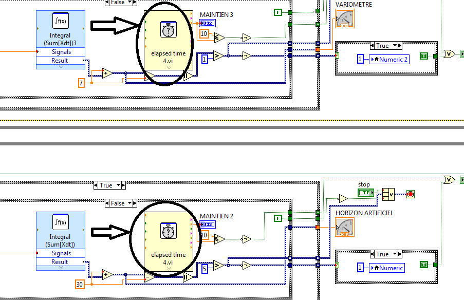

Right click on the Elapsed Time Express VI and choose "Open Front Panel".  It will ask if you want to convert from an Express VI.  Do so.  In the new VI, open the VI properties and change the execution to not be reentrant.  Save this VI somewhere in your project.  Now replace the other Express VI call with your new VI.  They will now use the same instance of the Elapsed Time VI (your project specific one) and you will only have 1 timer.

i did it but it seems that it doesn't work.the moment i changed the Elapsed time to VIs,the main VI didn't work exactly the joystick it doesn't work anymore1.png

Hi archfire,
Could you please be more specific on what you are looking for and what exactly seems to be the issue? I understand that the joystick does not work, but what is incorrect? Can you please post what the expected behavior should be and what is currently happening?

It is really not clear what you want, but here are some ideas:
  1. Wiring the millisecond timer value to the start time input makes absolutely no sense (you do this in two places! Why???!!!!). The value there is completely random.
  2. The elapsed time express VI is reentrant, so if you only want one per loop, maybe you should place a single instance before the inner case structure.
  3. If you would leave the stop buttons at latch action, you would not need the property nodes. Why did you change it from the default action?
  4. Your "numeric" and "numeric 2" belong in shift registers, no need for local variables.
  5. ...
  6. ...
  7. ......

for the elapsed time when the VI starts is not a problem.the problem is the maintain(the 2nd elapsed time) that i want calculate
what i'm looking for is:i wanna calculate the elapsed time for the student to maintain the 2 values in the same time 30 in the right one and 7 for the one on the left.so the counter of  elapsed time that i'm calling in the VI maintain shouldn't be calculated until the user could reach the 2 values 30 and 7 then the counter begins.the problem that i have is the moment i reach 30 or 7 the counter of maintain starts,i don't want that.
