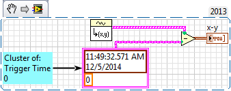

Not easy to do as a waveform!
Convert to XY Pairs and subtract trigger time from X
(2,824 Views)
The graph still accepts the older style cluster of data. No need for a waveform data type or xy graph.
