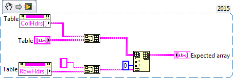

      Get the row and column header value using the property node and build it to obatain the required output format.
Refer to the below snippet and connect the expected array output to your vi and it will work fine .Hope this helps 🙂

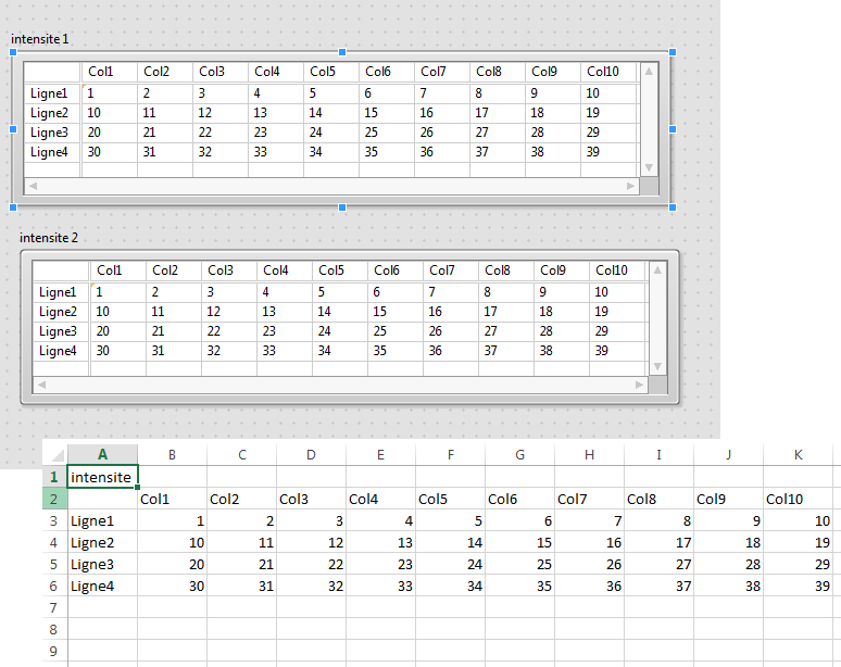

Here is it 🙂 sor example i can name its columns (intensite 1,intensite2...)

I  just want to give a title to the excel table
Message 6 of 12
(4,515 Views)
oh ok i understood. you want to give the tittle at the top and then followed by the content inside the table in a xl ...
is the below image is your required output???

Yes Exactly 🙂
