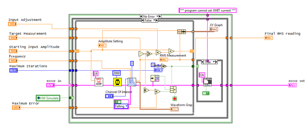

how to improve while loop
I have this while loop that I want to make improvement on.
Does anyone have any suggestions on what to do?
The loop start by setting a STARTING Input Amplitude on the Frequency Generator.
per iterations up to 40 only, it will increase about 0.002 (input adjustment)
Then read the final RMS reading. If FINAL RMS reading is within 0.1259  +- 0.00073 then stop the loop.
This is a Linear.
Can anyone suggest a way to make this easier?
Running the loop 40 times to get to the desired value is not ideal.
Any sugestions would be great!
thanks

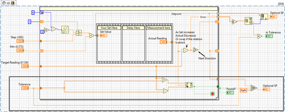

So, with a binary search you can do it in 6 steps ( or fewer)
Excuse the sloppy fast demo
Message 5 of 18

thanks for the visual!
I'll try it out. thank you!
What is optional SP?
Krispiekream
Message 6 of 18
(5,820 Views)
In my snippet the code in the flat frame decoration could be used to exit the for loop early if a setpoint is found that is within tolerance.  The other situation is to always find the BEST setpoint rather than one that is "Close enough"  It depends on what you really want- Accuracy or a potential throughput increase.  Either way you save a bunch of time over a linear search.
