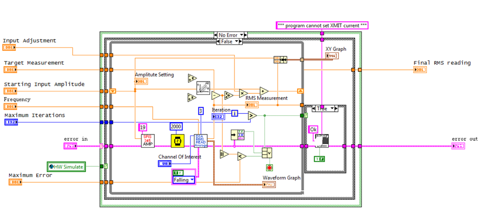

the data is 100% linear.
my senior engineer did mentioned to use the slope methods but haven't program labview in over 2 years.
I have never seen it done before. can someone show me where to find examples so I can look at?

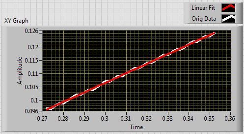

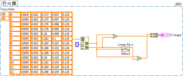

Your original data looks a little choppy ("White" Line). Rather than using any two points, I would use the Linear Fit.vi. Outputs from that VI also include the slope (M) and y-intercept (B).
EDIT: x-axis is your "Input" Column, and y-axis is your "Measured" Column

how would I use the linear fit to the current while loop I have?
Krispiekream
Message 16 of 18
(1,802 Views)
Start with y = Mx + B. The linear fit.VI gave you M & B. You know what Y is (Target voltage). SOLVE for X!! That's the amplitude setting of the Frequency Generator.

OH Come On Jam!  if he forgot LabVIEW in 2 yrs how do you expect him to remember 7th grade algebra?
x=(y-B)/M
