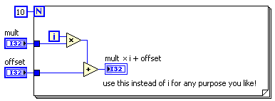

how to let " i " of a for loop to start from a "X"
how to let " i " of a for loop to start from a value "x" where x is a variable?

Hi starfish,
by adding this start value...
You can have any value by using a formula like y = a × i + b Smiley Wink

Thx 4 the reply
but how to make the conection. because i want to make the " i " act as an input not output

Hi starfish,
use it like this:
If this doesn't fit your needs you should attach an example of what you really need!

THXXXXXXXXXXXXXXXXXXXXXXXXX ALLLLLLLLLLLLLLLLLLLLLLL
