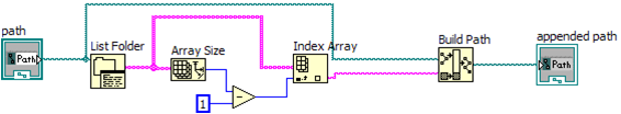

If you find that file, you can read it yes 😉
Se picture

Tim,
I also figured out, it's a bit different with your but it does the job.
Thanks for the help.
Raymond

Because List Array returns files alphabetically I think you will run into problems with your version if you have files Picture 99.jpg and Picture 100.jpg or things like this.
 Logically 100 was saved after 99, but your vi will return 99

Tim, you're right, my code only works when picture's name has number less than 99, I switched to you code and it works well.    Raymond
