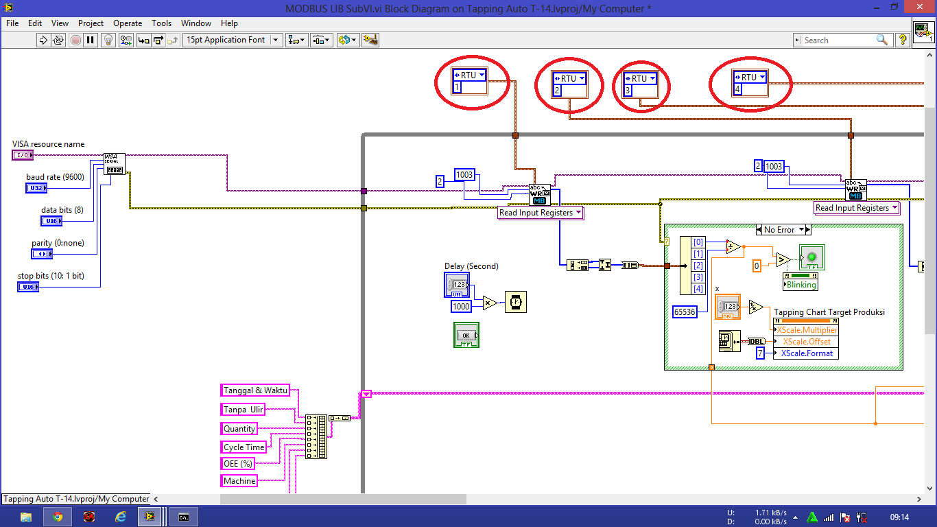

hi all, i create a program for my machine, its need 4 device that support rs-485 communication for 1 machine. i make a complex program for this project, my program now just for 1 machine, but for future i`ll make it for 12 machine (4 x 12 machine = 48 device) its will be 12x complex program, i want to make its a simple program by use subVI, the different for every machine is just on peripheral number of device (Serial Parameter)
please help me how to made simple program by subVI, i try subVI on while loop its over than 28 connector, any idea ?
i hope you understand what i mean. thanks~

If I understand your problem here, then read about clusters. Specially about type definied clusters!

forget about wait ms and all about the loop, i just want to make my program simpler as possible, that program that i`ve made is just for 1 machine, when you see my program is so complex isnt right ? it just for 1 machine, and for future i`ll make it for 12 machine in one program (one block diagram one front panel), maybe i`ll copy program, all of program will be same just different on numbers of RTU (Serial Parameter) for every machine,please see red circled.

Create a FOR loop, and initialize 12 VISA references for your 12 "machines" (autoindex into the FOR loop the 12 serial COM port as an array, and you get the VISA refs autoindexed out as a VISA ref array).
Create a subVI out of your 4 Modbus Read functions, with an input terminal of a single VISA reference!
Put this subVI into a FOR loop, and connect your VISA ref array into it with autoindexing. Inside this FOR loop, connect the autoindexed single VISA ref to your subVI. Your subVI will give out a 1D array of the results of the actual machine of the 12. If you autoindex this out through the FOR loop, you get a 2D array of results. How you want to form your data, it is just up to you...You could also use an array of typdefinied clusters (the array elements are the machines, the cluster elements are the local results of each machines).
After your while loop, you can use again a FOR loop, to close your 12 VISA references.
Still, this VI what you show is poor in style, and does not have any error handling!
