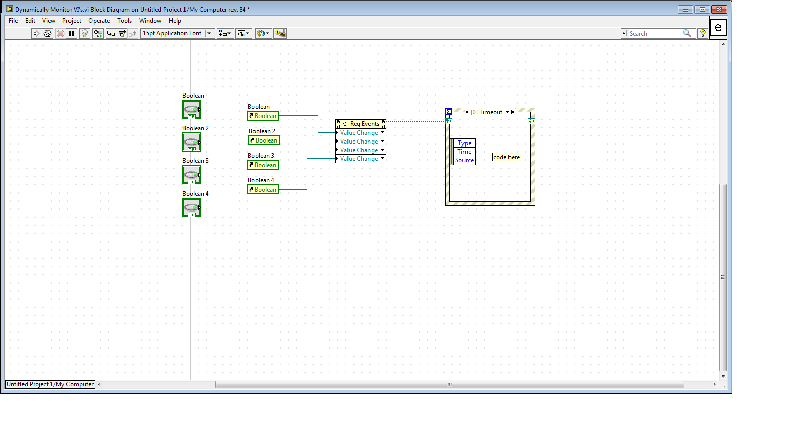

RavensFan - can you give me a little more detail on the dynamic event registration?
here's what I gather...
1. Create a cluster for each register.  The cluster contains all the controls for said register (up to 16).
2. Use a loop to iterate through each cluster.  Within the loop, create a reference to each of the controls and register that reference for a value change event.
3. Pass this registered event reference to the Event Dynamic Registration input of an event structure.
4. Populate the event structure with 'genericized' code that performs the boolean math
Am I on the right track?
Message 15 of 20
(2,756 Views)

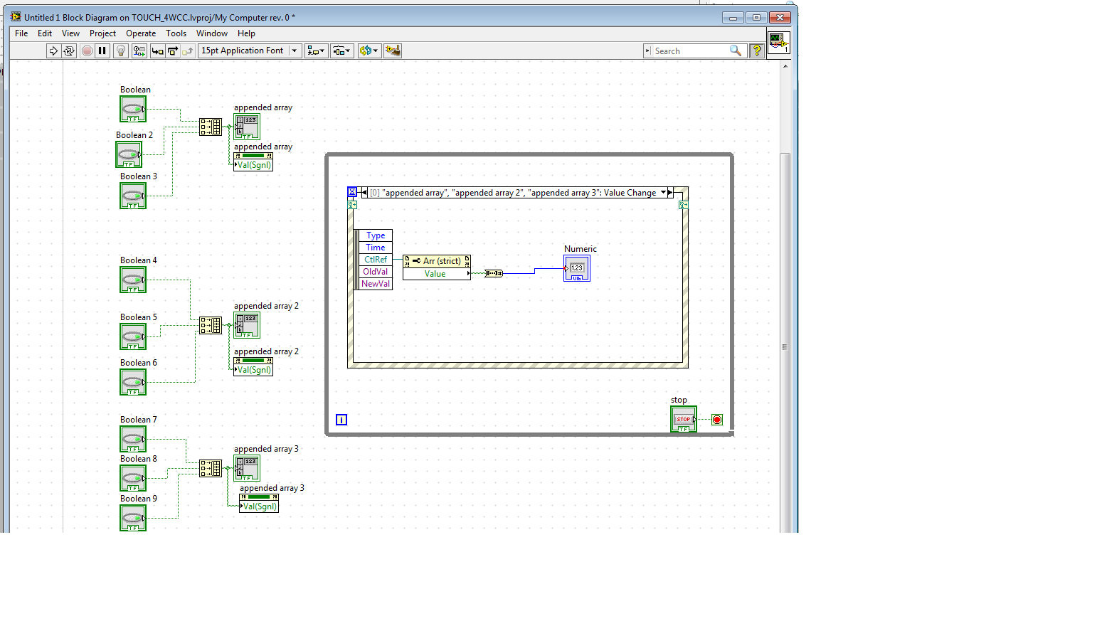

I would recommend an array of 16 bits (bools) over a cluster of same- much easier to work with. You will then just get one change event for the array- inside the case of this event you can figure out which bit changed (by comparing with previous array value) or simply use the complete new array to recalculate your 16 bit value.
Message 16 of 20
(2,743 Views)
like this?
Message 17 of 20
(2,737 Views)
by the way I know that example doesn't duplicate the boolean math from before, it's just meant to be a proof of concept to ensure we're on the same page.
Message 18 of 20
(2,736 Views)
Actually,  make those array indicators controls (You simply don't need the scalar booleans) Worse, since you write Value(Signaling) FOR each indicator EVERY itteration you managed to do something really really BAD  you generate multiple events each iteration and can only service ONE.  That will queue up more and more events that just can't be serviced and other events (Like STOP) will need a long long time to wait before they can be serviced.  (Yes Value Signalling ALWAYS creates a Value Change event- even if the value is unchanged):smileysurprised:  I'm assuming this is why you moved the P-Nodes outside the loop.
and why does that NOT duplicate the bool to number conversion?  It DOES!
Message 19 of 20
(2,728 Views)
I'm talking about making your front panel control an array of 16 bools- not having individual bool controls that you then package into an array in code.
No bool controls at all- just arrays of bools.
