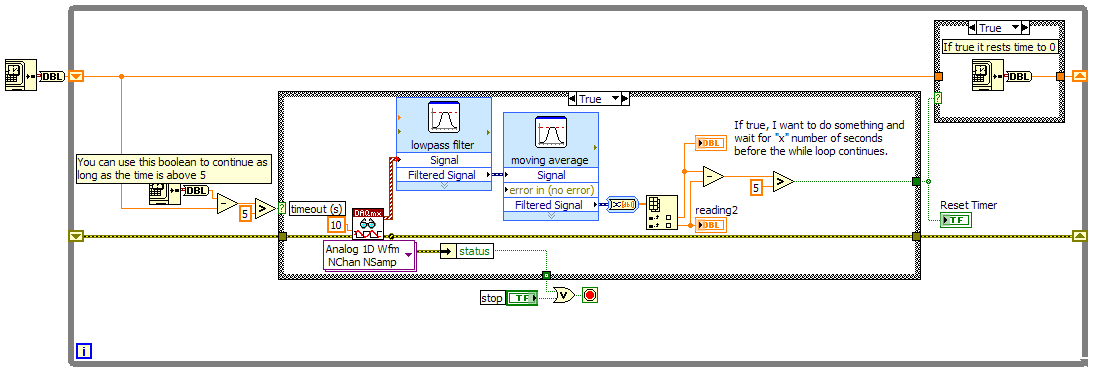

I think I would do it like this so I do not get hung in the code.
21912i48174F813AB7C00A

aeastet,
I have Labview 8.6, so i can't open your attachment. Is it possible for you to save it in a format which I can open?
I wanted to see the file because I don't know what those "time reset" VIs are called. I'm talkin about the ones with the DBL symbol attached to them. I don't understand those either..
Thanks!
Message 7 of 8
(4,162 Views)
here is 8.5 version.
Tim
GHSP
Message 8 of 8
