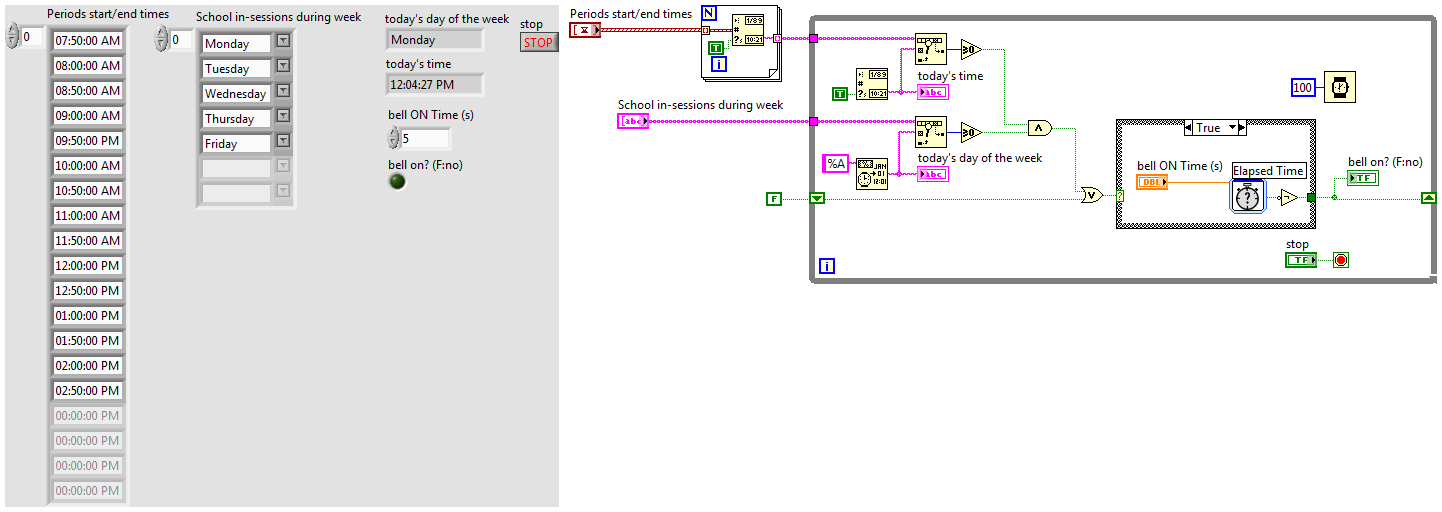

basically pick the times the periods start and end, including the days of the weeks...
Spoiler
