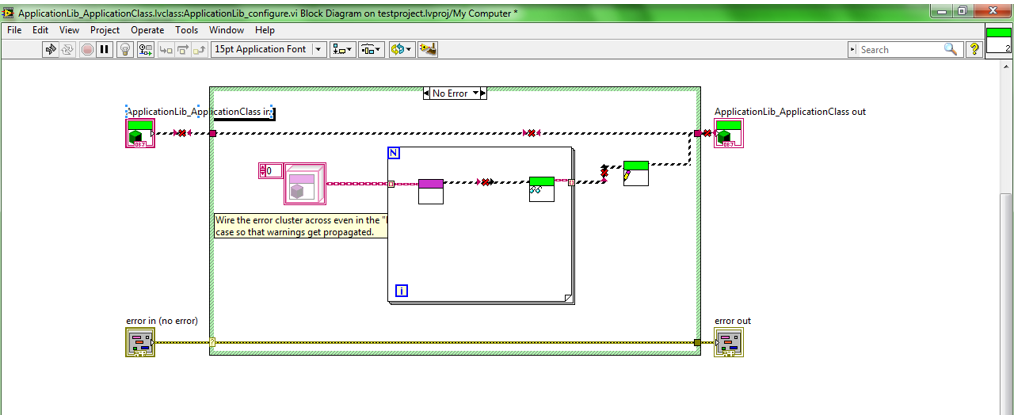

Hi.I am new to object orient approach .I am developing a project which has a class as application .My class has it state control as another class which is notification class.I want to use my notification class method (init)in my application class method .i have also used read and write accessors vis.But i have broken lines in my code.Please help me correct it.
 and print screen is attached below.

The errors look like you have tried to connect classes of different types together where either (and therefore incompatible) 1) the classes are completely unrelated or 2) the classes are related but you have not set the inheritence (e.g. child/parent).

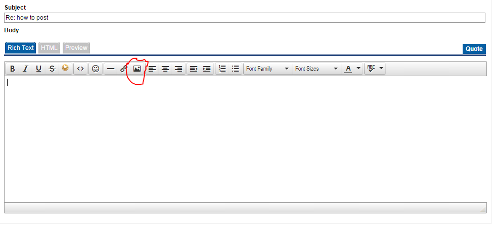

You insert an image in a post by using the Insert/Edit image button. (see below)
From the image that RTSLVU posted, 1) seems to be the case.
You appear to have two classes.  Let's call these classes "Class CB32CB" and "Class 00FF00" based on how you've identified them on the block diagram.  Both use the default wire style and color.
You have a constant of an empty array of CB32CB's which are autoindexed in a for loop.  So the loop doesn't execute.
However, that won't break the VI, it just may make it execute contrary to your expectations.
If you had some elements in the array, then for each CB32CB you call what appears to be CB32CB's "Blank" method.  Ostensibly, the top-right terminal here is a CB32CB.  You then try to pass a CB32CB into the top-left terminal of what appears to be 00FF00's "Read Nothing" method.  Ostensibly, this terminal should be a 00FF00.
That would be your problem - you are trying to use a CB32CB as a 00FF00; inferring from your description, the 00FF00 probably contains a CB32CB as a member datum.  What I would recommend is making a constructor for your 00FF00 that takes a CB32CB as an input (NOT on the top-left terminal) and outputs a constructed 00FF00 (on the top-right terminal) with that CB32CB inside.
