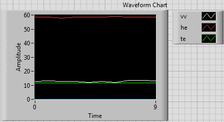

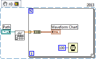

this is what i do .

That's because you are not using the 2D array output.
Message 13 of 27
(1,398 Views)
It is also just silly to keep reading the same file over and over. Move it to outside the loop. Same thing for the Index Array if it's always the same column.

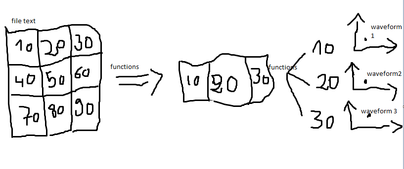

you read the value of the point.
if the first line is over. we start the second one.
values which are in a same column will be in a same waveform.
for example 10 and 40 are in a same waveform

I have a hard time understanding. With a single index array, you can read all columns and write to separate graphs.

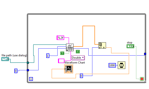

I think this will do what you want.
This assumes your text file is tab delimited. I tried it out by creating a text file from the image you originally posted.
