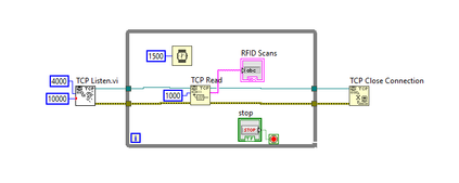

Hi Mark,
Thank you so much for your reply. I finally got my very simple VI to read information from the ethernet port for my RFID readers. I now have a different challenge.
I am trying to make it so once an RFID tag gets scanned, LabView receives it and can use the existence of the individual scan to trigger other commands within my program. Is it possible to make it so when a tag is read, I can turn the "string" from the TCP Read into a digital signal (1 or 0) or a boolean signal?
Along with that, is it possible to filter the string received from the TCP Read so I get individual tag scan info?
Below is my block diagram and example of the string output I am getting.
Any sort of insight is appreciated, thank you.
