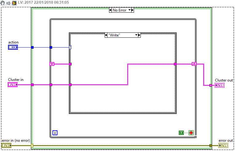

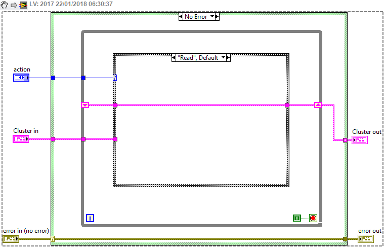

@shaunmarsh123 wrote:
Hello ! i have a cluster containing 256 boolean elements , which i am using as checkboxes for my application. I want to add cancel button functionality to my application, so that when i click the cancel button, all the changes that i have done on the checkboxes revert or goes back to previous state. Can u please tell me how can i implement this ?
Use a Functional Global Variable to perform Read/Write actions, see snippet below. You can just store the actual cluster state inside this FGV, and when the user selects "cancel" in the corresponding Event case, read out the previous content of the FGV, and use a Local Variable of your cluster in write mode, to revert back to the prev state...

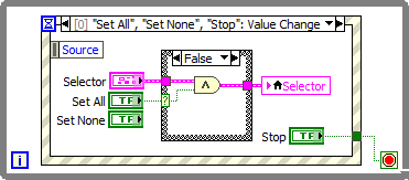

Write back to the control via a local variable.
To make all FALSE, do a "AND FALSE".
To make all TRUE, do a "OR TRUE".
(boolean operations with a single diagram constant)
Message 3 of 9
(3,550 Views)
Here's a very simple demo.

@altenbach wrote:
You forgot the question was about a "cancel" or "revert back changes" functionality. But using your VI, the OP can easily implement the required option (or using the FGV I showed, or a shift register in my main while loop...).
By the way, to use such monstrous cluster seems a bit counter-productive. I would use a 2D array of Boolean+text clusters, much more scaleable and you can easily access array elements. Much better than what you do now... See example here: https://forums.ni.com/t5/LabVIEW/Create-checkboxes-programmatically/td-p/3664192
 To add to that idea, the AE/FGV could have an array of clusters internally. That way each change adds to an array and each cancel/undo removes the last element. It'd be a nice feature. 🙂
