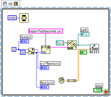

Do you mean you want to save like this?
Message 3 of 16
(5,062 Views)
Hi muks,
even in LV8 you should use proper functions to build a filename!
18169i8A40307EE314CEF9
Message 4 of 16
(5,056 Views)
But what i showed is also a way right?
Message 5 of 16
(5,050 Views)
Hi muks,
"But what i showed is also a way right?"
Yes, a way that may brake when porting to a different OS...
When helping someone, who made his/her first post here on a basic question and so seems to be new to LabVIEW, he/she should get a correct answer with correct use of LabVIEW primitives!
