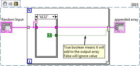

I want to save modified data (individual strings of data) to an array and/or to an indicator which shows all the iterated strings. As you can see from my code attached each value is being overwritten by the next one. I want to save all the iterations and not just the last one. Need help please

You are missing some basic understanding of how LabVIEW works. The wires control the flow of data, but don't store that data. Every time you write a value to your array, you are overwriting what was previously shown on that array. You need to use shift registers to store info from loop iteration to iteration, or you need to output the array from the array using auto-indexing.
Here is how you can do it with a conditional terminal output from the loop.

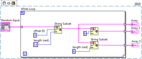

Do you actually want to use a case structure? My understanding was that you have an input array, want to manipulate each element in the array and output three new elements into  three arrays? The screenshot below seems to do the trick (if that was your intention). As James.Morris said, you can take advantage of auto indexing. No need to wire anything to the count (N) terminal.
