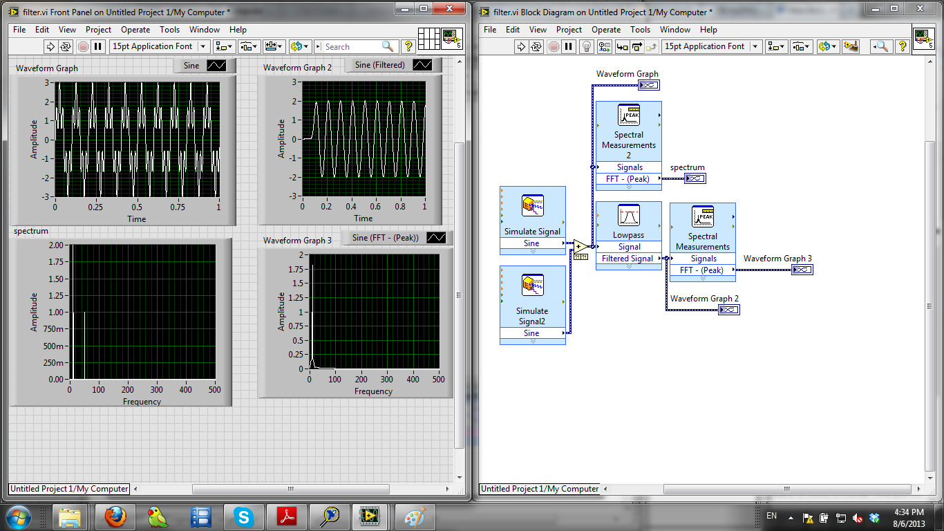

I have done a quick simulation, by just adding a 10Hz sine wave and 50Hz sine wave, and perform the analysis and lowpass filter and seems like it is working fine.
Please take a look and see whether does it fit into your need, thanks.
