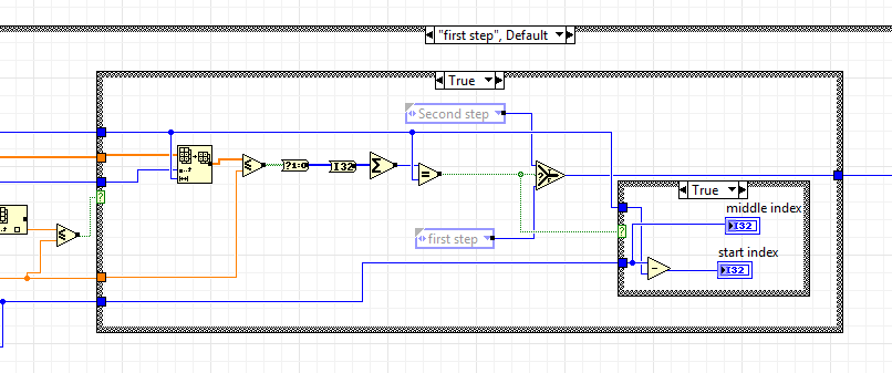

I only have a few minutes before I need to leave for the day so I will only comment on two simple items.
1. The typedefs. Open the Context Help window.  I always keep it open while I am programming. Move the cursor over the enum constants on the block diagram. The constant which  initiailizes the shift register is unnamed (label is empty). In the True case of "first step" one of the constants is unnamed while the other has label 'f'. I discovered this because the typedef file (the .ctl) was not included which creates errors. The error list showed two different errors, depending on the label of the enum constants.  If the only difference is the label, I think it will not be a problem, but it indicates that the constants were probably created two different ways.

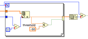

`Some of your manipulations could be greatly improved.  As an example lets look at this section with buffer allocations shown:
Those black squares show where LabVIEW needs to allocate blocks of memory.  Tools>>Profile>>Show Buffer allocations is very handy.
Here we see that the array subset allocates a largish array that isn't used except to create a large arry of bool- cast to a large array of U8 Cast to a large array of I32 just to get a count of elements above threshold
This is equvalent and a lot less memory is used

Thanks for the improvements.  I was not thinking about memory when I put that together - only that it was about 5 times faster than the original.
Note that the Array Size output will be equal to the value in Numeirc Control unless that runs past the end of the array. So the Array Size may not be needed. The OP will need to decide how to handle that case if it can ever occur.
Al-rawachy,
The attached VI shows how I eliminated all the local variables by  using wires and shift registers. This does not include the changes Jeff suggested. That code is inside the Count.vi. To try Jeff's code make a subVI from his snippet. The Replace Count.vi with that VI. I do not have the IQ subVI so I substituted other code to provide some data for testing purposes. I also disabled Request Deallocation becaues it is almost always not needed.
