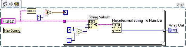

Is this you want...

Bijay,
when the string has odd number of characters, the logic might not work correct.
we should be grouping HEX characters from left most bit... so, i modified your code as attached.

Hi
In that case, wire the output of String Subset directly to the output. Remove the Hexadecimal string to number function. you will get an array of Hexadecimal strings, of one byte each.

hi
it would be better done that way.
else, if you do not want FOR loop, you will have to repeat the 'String subset' function manually till you can get the entire HEX string broken up.
but, why do you not want a For loop? what has it done to upset you so?

If your number doesnt go too large you could convert the string to a u32 and use split number.

Yes
As IanW mentioned, you should definitely know the sixe of the HEX string to code that. if the hex string length can change, it is better to use FOR loop
