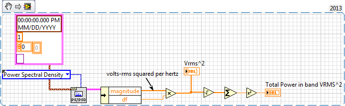

You probably want something more like this:
but thats a guess...
Message 8 of 9
(4,905 Views)
Perfect!
