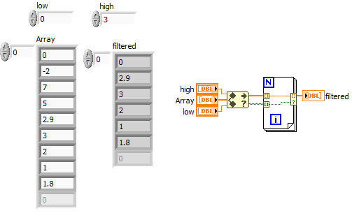

Yes, we got that by now and you have received exact advice from Ben and Gerd that you seem to ignore(?). Is your LabVIEW version so old that you don't have the conditional tunnel? In that case the solution is very slightly more complicated, but you should be able to figure it out.
Here's what Ben meant long (long!) ago. Note that if the further analysis assumes equal time spacing of the points, this will no longer be true after filtering. (don't do a FFT or graph on a chart!) Also note that the limits can be inclusive or exclusive (look at the diamonds on the icon). Of course even if a value is in the correct range, it could still be bad for some other reason and there is no way to tell.
(Also note that the primitive can be inside or outside the loop, something you might consider testing if the arrays are gigantic. While the primitive could possibly be faster when operating on an array, the additional cost is allocating a boolean array. Only a careful benchmark can tell what's best but it probably really does not matter. OTOH, the compiler might move things around anyway. ;))
