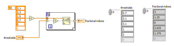

Instead of reversing, which potentially needs to move every single array element in memory, negate the array and search term instead. Better in-placeness (unless the compiler can do some magic with the reversal). Now you even get the correct index directly.
Works just fine!:
(Note that the correct term for the array requirements are "non-descending", so you need to make sure this is true.)

Yes, for certain operations the compiler just flags that the array is reversed without making a new copy, but it is not clear if threshold array understands that flag (doubt it) or always expects a plain array. And we still have the problem that the returned fractional index is different from the index we want, i.e. the positions in the non-reversed array. I would go with "negate". 😄
