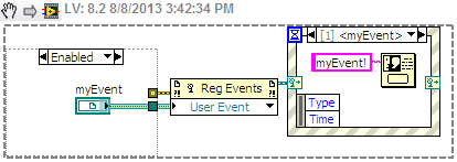

I'm not following you.  If this is my main VI:

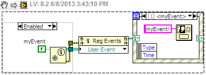

My sub VI only works like this:

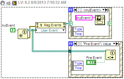

This doesn't work:
What have I missed?

I'm still not following you.  I've named the event "myEvent" in both VIs and it doesn't work.
