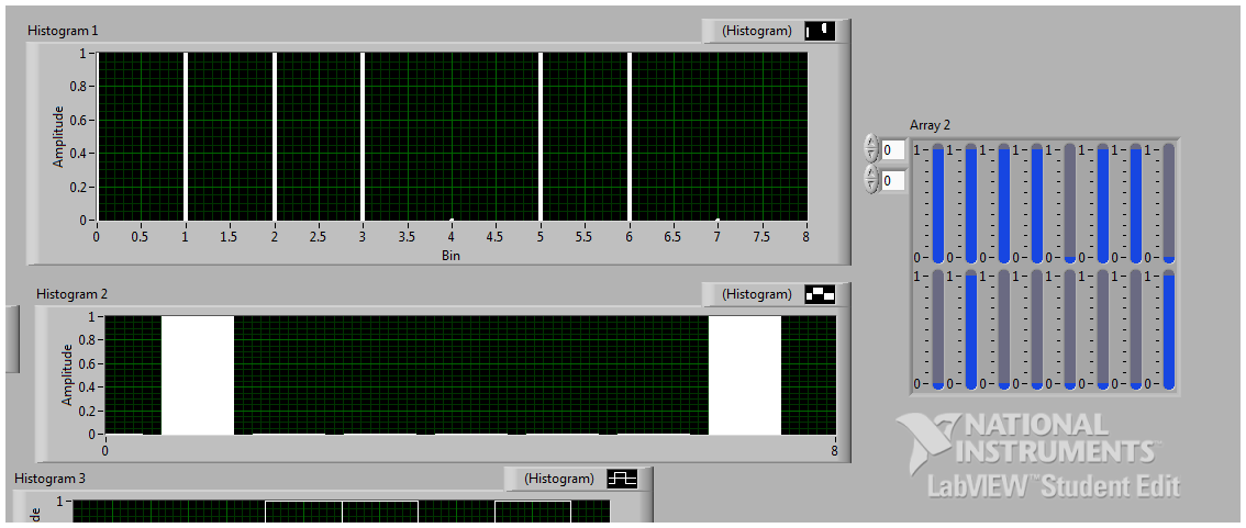

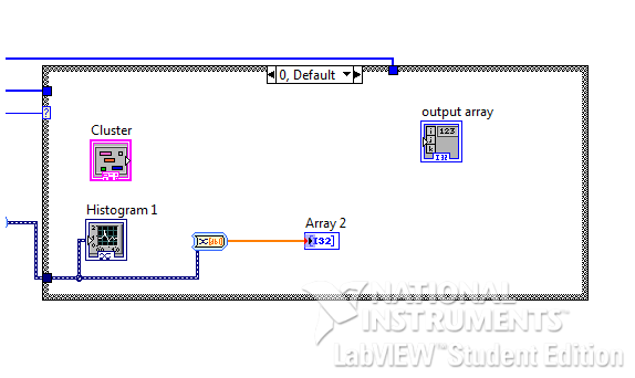

 Here is my code,
so I basically want to write the values of the table (each row) to 8 sliders.
For now I just want row 1 to be displayed on the 8 sliders.
I tried using the array to clusters, but I can't seem to get it working...
Thanks!!
(3,764 Views)

How did you create those sliders? They are actaully clusters of two elements, both of which appear to be identical sliders sitting on top of each other.
That is probably why you are having so much trouble wiring your data to them.  I suggest that you create a new cluster with standard sliders.  Then you can use the Array to Cluster primitive to move the data.

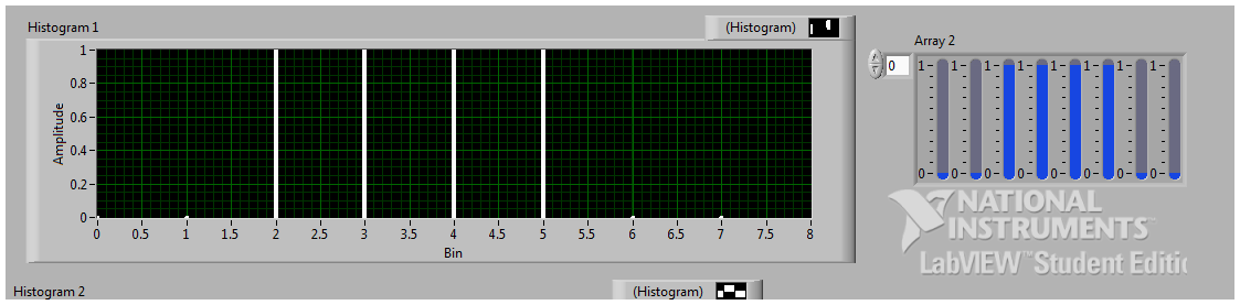

i think you want to make a 1d array of sliders to match your graph...
and i think you want to represent your 2d array with your sliders as oppose to your cluster of 2 element cluster...
(3,726 Views)
Thanks! I have no idea how I ended up creating the sliders like that, I figured it shouldn't be this complicated!!
But it works perfectly now!Smiley Happy
