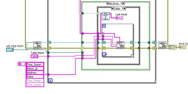

i m using mysql data server
my data is
actually with out db developer tool , my frnd has some thing with db.. it was writing into db
here it is
like this i want to do add in my code

Your statements are confusing. You say ' actually without db developer tool' but then you show an image of a block diagram with functions from the db development tool. You either have it or not. If you don't, get one of the free toolkits. I've used LabSQL quite a lot. There are others - do a search.

Do you have the table created with the columns? What are the datatypes? Did you create the UDL and try to connect? How do you want to update the db? The example shows one large write - apparently when the program is complete. Or, do you want to write as data is acquired, one row at a time?
Personally, I've always thought that the NI toolkit was overly complicated for a simple insert. I just checked and I don't even have it installed right now so I'm forced to give generic help. There are numerous examples with the toolkit. Which ones have you run?

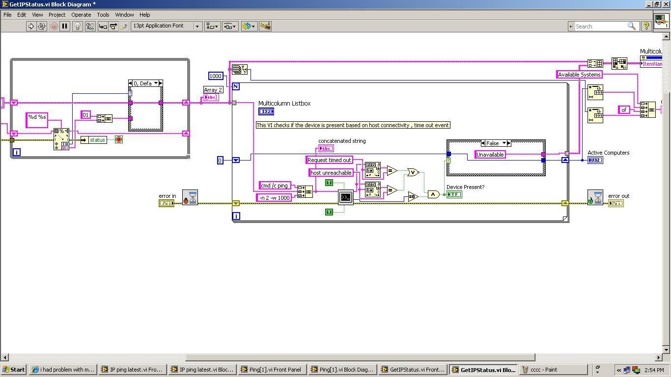

Hello ,
I can give you some snip shots how I created using database tools . First is how to open the databse. I also just learnt by trial and error and by reading the manual for data base.Then i will post more of these so that you can build your own just chnage the names and i think it will work .
Message 9 of 10

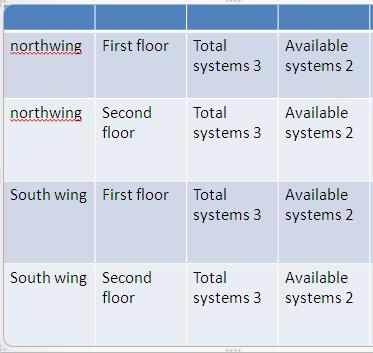

The second is save to setup table in access. its not much clear but it works for me.
Message 10 of 10
