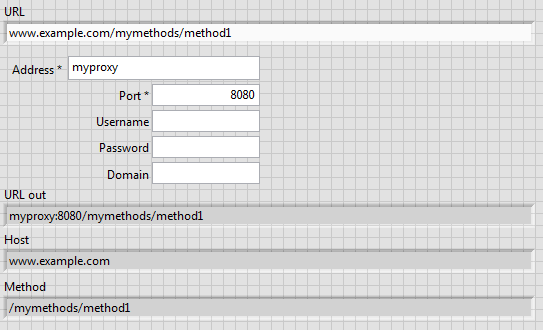

First, I take the URL apart and create a new URL aimed at the proxy:

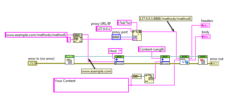

Second, I run a POST method as follows:

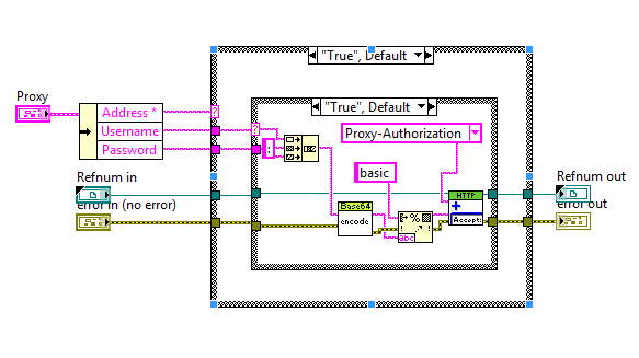

Third, to provide basic proxy authentication, I created a subVI that I added to the code above (the base64 subvi below I found on this website):
Fiddler is a great tool to get all this working. After installing it will provide you with a local proxy @ localhost:8888 and you can set it to require basic authentication (using username 1 and password 1)

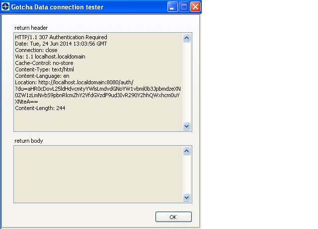

Not quite there yet!
The proxy responds with a 307 redirect.
It wants me to to repeat the post command, but targeted at another URI:
I am not sure how to format the header of this new request. As explained above, the initial request is targeted at the proxy server. I could target the "location" (mentioned in the image) instead, but that one contains a path and arguments. This would yield an invalid request for sure. like: POST http://localhost.locadomain:8080/auth?du=long...hash/mymethods/method1 HTTP/1.1 (This URI contains two paths and a parameter in between..)
Any suggestions?

That doesn't look like a rederict but rather like an authentication request. Probably because localhost.localdomain doesn't allow for your Basic authentication. Is this your final location or your proxy server?

307 instruct that you have to do your request targeted at another URI , which it returns in the location header. So far so good. My Location header already contains a URI including an authentication string.
I am guessing that I need to authenticate at this new URI, keep the http session open and then re-issue my POST request with this new http://localhost.localdomain as the new proxy.
I created a test application for the customer, but this may become a lengthy process as long as I don't find any literature on the subject.
