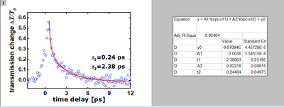

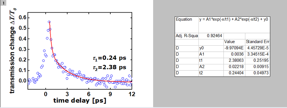

I would like to create a fitting function in LabVIEW that fits the data starting from a specific value, similar to the provided shape. I am sharing a sample dataset as a .txt file. I would appreciate it if you could help me create this.

@dlehdgh20 wrote:
OK, this is a double-exponential decay with offset starting at the peak (which is not exactly at t=0 so you might need also a parameter for that unless you can guarantee that t0 is at the right place. Then you also need some criteria what points at negative times and near zero to omit. Obviously, all points to the left don't fit the red line at all. Alternatively, you could use a more complicated model where the left is an exponential rise Or you could set the weight to zero to ignore these points.
Should the program determine what points to omit, do you want to use a cursor to manually select, or do you just want to keep all values that have nonnegative time delay?
Note that your results are truncated and we cannot read the value for y0 (missing the digits after the E). Are you sure that we cannot assume that Y0=0, simplifying the model?
In any case, if you look at some of my examples you should have no problem implementing this as long as you have some basic LabVIEW knowledge. Do you?
