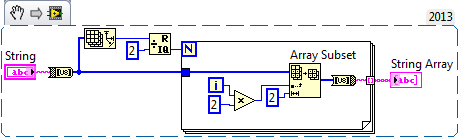

Hi nouman,
what have you tried so far?
Did you use StringSubset? In a loop to get parts of your input string? That would be the most forward approach…
Here's a different approach:
P.S.: no need to post twice when you can edit your own message!

yeah i tried string subset in a loop but i didnt got my desired results.
the thing i am trying is that the first two characters of string to be placed at index 0 of array the next two on index 1 and so on.

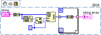

Here's another take on the solution.
Here are the results that it provides:
Is this what you are going for?

thanx both of them works for me one converts in a row second one in a column
Message 6 of 20
(8,205 Views)
They actually give the exact same result.  I don't know what you mean by a row vs. a column.  They both give 1-D arrays.  Whether it looks like a row or a column is just a function of how you drag out the array indicator to show multiple elements.
