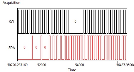

the graph answer

Without fully understanding what results occur from reading a I2C signal with the 6556, I cannot say why the 6556 is not able to perform the acquisition you are looking for. If you are reading all F's, it sounds like the device is holding the line high rather than tristate. Are you generating values with the 6556 at all? HSDIO uses a hold-last-value model, so if the last generated sample is a 1, it will hold that value indefinitely, which could be what you are seeing.
