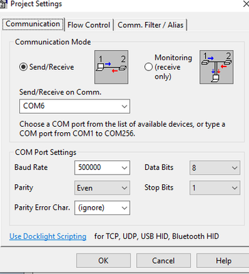

is there a property available to ignore the parity errors in LabVIEW/Visa for example docklight software has the ability to do this.
I'm testing an RS485 port from a product and the below settings were required to perform the test
