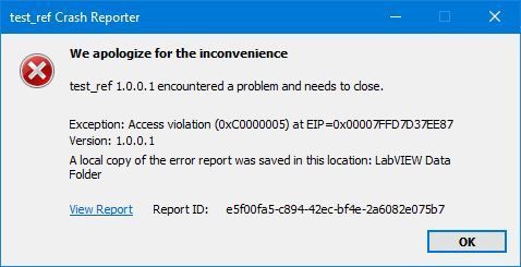

Just thought I would add a bit here about my experience. I was gonna add the image control ref to a class I was building. I, of course, needed to use the work-around to place the control into the class private cluster. When I built an simple application it did crash the first time but ran subsequent runs. I got the following error.
I repeated the process: built the executable and ran it with a crash. I disabled my antivirus, rebuilt, and tried again and it ran fine first time. I then tried replacing the image control and reference with a waveform graph in my test project. When I built it, it didn't crash regardless of if AV was running or not.
This workaround and the crashes don't fill me with confidence going forward using the image control reference. It would be nice to know if people have built large scale applications with control references in subvis and classes. Obviously, something is not quite right with this thing.
