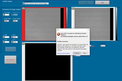

I'm controlling 2 sCMOS pco cameras with the example VI they gave. I started from the example and modified that code to implement image processing in cpp to use in call library function. My task is to rescale array2(controlling magnification), translate or rotate array1, and then subtract array1(the red boundary display on left) from array2(the right display) to form array3(bottom display). The problem is that
this kind of memory error occurs every time but if I click continue, the error sometimes fades away and the VI operates normally but sometimes not.

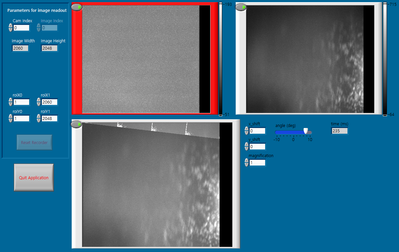

If it operates normally after I click continue in some cases, the display is shown like this but I can observe the very awkward pattern on the top side of array3 so I guess there is a problem but it is hard to troubleshoot.
Do you know reasons of my problem and how to fix it?

Generally I would do your specific operations in native LabVIEW. I don't see why you would do this externally.
However, check if your set types and connected wire types at the call library node are correct. If those are correct use the IDE you use
for your DLL's to hang into LabVIEW process and debug your indexing.
Consider uploading a working minimal example containing your data and setup cln nodes.
CLA
(1,594 Views)
Lots of potential errors but my first rough guess is that your original image ROI you enter multiplied by the magnification is getting bigger than 2048 * 2060 pixels.
You can't just operate like in LabVIEW when interfacing to C code. Your C code does NOT adjust memory sizes of those arrays as needed, so whatever you pass in is what it gets. But if the C code then starts indexing memory outside of that passed in buffer, you get these errors (or a full crash).
