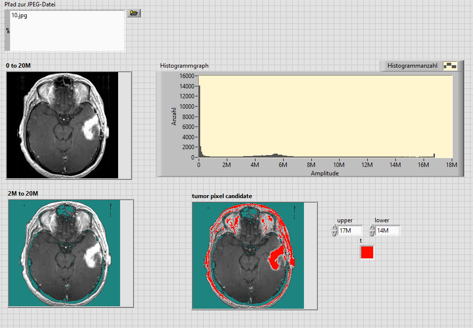

@Nardimes wrote:
am using MR image
Hi Nardimes,
you force me to guess what you want to do.
It is pretty likely, that you want to segment the bright pixels - which I suppose to be a tumor (foreground) - from the rest of the image (background)
If that is the case, this is a non-trivial task to do.
This is because in both images  those tumor-grey-values  occur in more than one region.
You need to choose a different segmentation approach,
or introduce more steps in your image processing, e.g.
distinguish between object and no-object pixels,
define a region of interest with-in the ovject pixel-region.....
I can not help you with that
