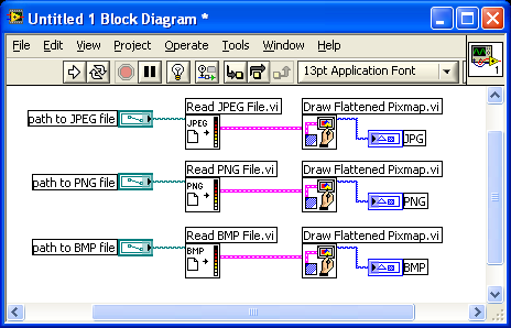

If all you want is to display a jpg, png, or bmp, you only need to use one of the read functions from the Graphics and Sound>Graphics Formats palette and the Draw Flattened Pixmap from the Graphics and Sound>Picture Functions palette as shown below. As far as displaying an image based on a number you get, you're going to have to provide some details on how this number will correlate to an image you have.
