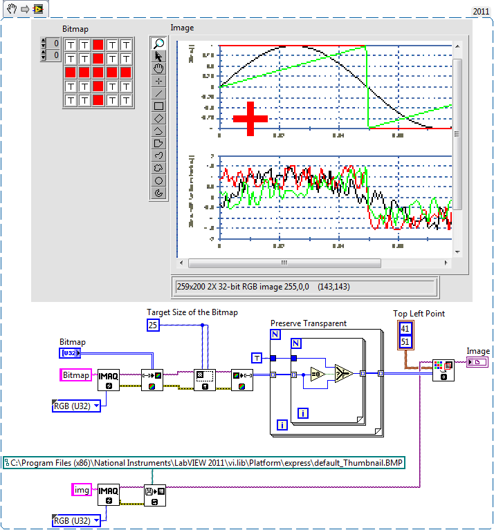

I have pasted the the FP after one VI run above the code.  You can see, that the small red cross increased in size to 25 x 25 in the Image Display.  As transparent pixels in the bitmap were not kept in the alpha channel, I simply used a For Loop in a For Loop to correct this Smiley Mad
Now its up to you to set the numeric value (instead of my BD constant which is set to 25) according to your desire.  And do not forget to clean up things, like IMAQ Dispose (which I did not here in the draft).
