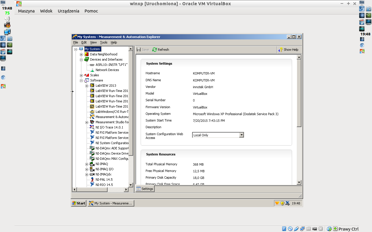

I have problem with use IMAQ driver- i had install VAS in version 2015 (my LabView version is 2013), activated it and i don't see option to select a camera in NI-MAX, but in section Software in NI-MAX IMAQdx is present. What is the problem? Versions of VAS and LV doesnt fit?

Presence of the NI-IMAQdx in your NI-Max software tree means that you have instaled Ni-Max IMAQdx drivers, but this do not means that your camera have been found by your system.
If you did not resolved your problem yet, could you provide more infomation about camera used by you? There should not be a problem with using different version of VAS and LabView.
