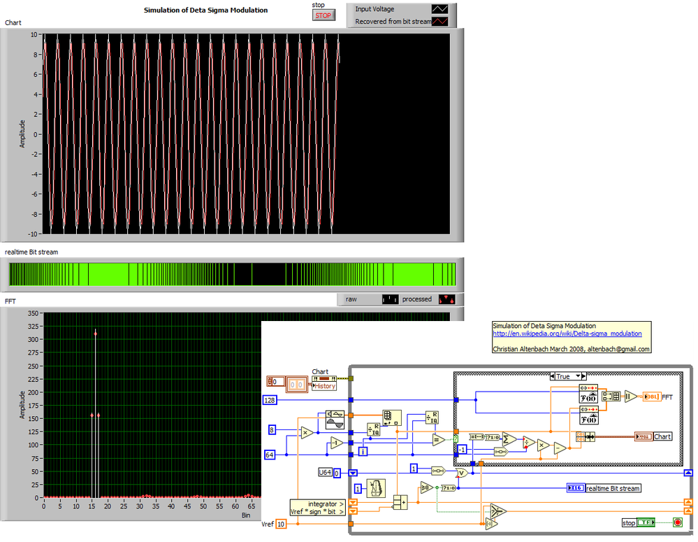

Hi Angelo,
I simplified your VI like this:
Why do you wire a "1000" constant to the FOR loop?
Do you want to process only the first 1000 samples of your 100k array?
Where do you recognize "noise" in your spectral plots?
Message 17 of 32
(768 Views)
in the spectrum what lies below the fundamental harmonic.
I will only take the 1000 since I am sampling at 1 MHz, and therefore over time I will display a period of the sinusoid at 1000 Hz set in the simulate signal
Message 18 of 32
(752 Views)
A more reasonable demo would be to simulate a continuous signal and analyze it ptbypt.
Here's a quick example (note that you need to correctly scale the frequency axis, of course. Currently it is in bin units).
Message 19 of 32
(742 Views)
I would like to use a simulate signal to see how the V.I. algorithm works and above all I would like to see in frequency the phenomenon of noise shaping, i.e. the movement of the noise in high frequency caused by the sigma delta loop, in this configuration this effect is not clear , you could use a Spectral block to see the various harmonics and noise level
Message 20 of 32
