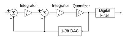

perhaps with this image the situation is clearer...
I want to create this sigma delta adc with two integrators, on labview do you have any ideas on how to do it?? give me advice
Message 27 of 32
(639 Views)
LabVIEW is a programming language, not a circuit simulator.
Message 28 of 32
(605 Views)
Yes, I understand, I'm asking you if it's possible with LabView to simulate with the blocks it provides, build such a circuit, which would be a second order sigma delta
Message 29 of 32
(601 Views)
Yes, you just need to implement the math, similar to what I already did.
