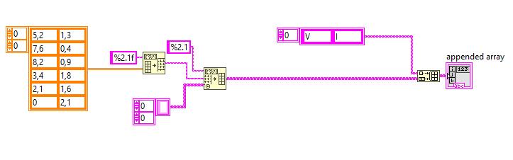

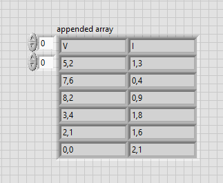

Hi
i find two solutions .
1) the first solution is to convert the array of DBL to an array of string and after that, use build array function to concatenate the array with the header .
2)  the second solution is to convert the array of DBL to an array of string and after that , use table from (List table, & Tree  palette)  to add header go to Properties.
(7,330 Views)
Accepted by Emna20
@Emna20 wrote:
Hi

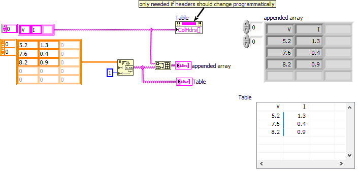

Your solutions are extremely convoluted and parts of the code make no sense at all. Why do you think you need to go from array to string and back to an array? That's a lot of expensive processing. Also, "%2.1" is NOT a valid format. Fortunately, the function ignores illegal formats and treats it as "%s" here..
Here's how you would do it instead. Much simpler! Same result. (See also)
