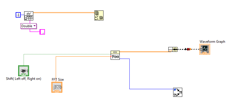

Below is what I have so far. I'm not sure on two things:
1) How do I use the index array block to select which column of data i want to use?
2) How can i connect that data to get a frequency spectrum graph?
Thank you for your quick response!
(5,130 Views)
Always have the Context Help window open when you are starting out learning LabVIEW. Did you do the tutorials? I'm sure they cover arrays. As I said, you need to wire a constant to the "column" input. See that little black square on the left of the Index Array? That's the "row" input. The one below it is the "column" input. So, either:
  • put a numeric constant on the block diagram (integer), and connect it to that input, and set the constant to the column you want
  • right-click on that input and select Create -> Constant. That will give you a numeric constant that you can then set.
As for the graph, that's not the correct way to use a waveform graph. It appears as if you are trying to do an XY thing. That's what the Build Cluster is used for. If you hover the cursor over the waveform graph terminal on the block diagram, and have the Context Help window open then it will show you how to build data for it. There are also shippiung examples on the various types of graphs.

I've been looking through some other examples but haven't found any of the tutorials. I can now import the csv files. Is there a better method to graph the output of the fft than a waveform graph?
(5,120 Views)
To learn more about LabVIEW you go can through the introduction material, tutorial(s), and other material in the NI Developer Zone's Learning Center which provides links to other materials and other tutorials. There are also several Technical Resources. You can also take the online courses for free.
In terms of the graph, you can use an XY graph instead of a waveform graph. A waveform graph is designed to be used with equally-spaced datapoint. An XY graph is not. You wire your array of freqencies to the top terminal of the Bundle function.
