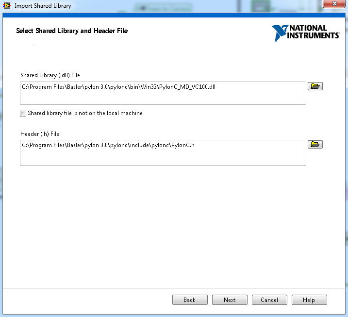

I am trying to import a dll. All of it. I will need almost all of the functions. I have tried using the Import Library Function Node, but I realized that it is very time consuming. Also, there are functions spanning too many different header files. so I am trying to use Tools -> Import -> Shared Library (.dll). I get stuck with preprocessor directives. I am posting step by step:
The message for the first function is:

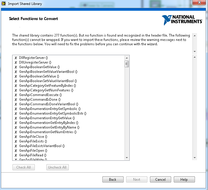

The function cannot be imported into LabVIEW. This might be caused by one of the following problems:
The function is not declared in the header file but is exported in the library.
Check the header file to make sure it contains declarations of the function.

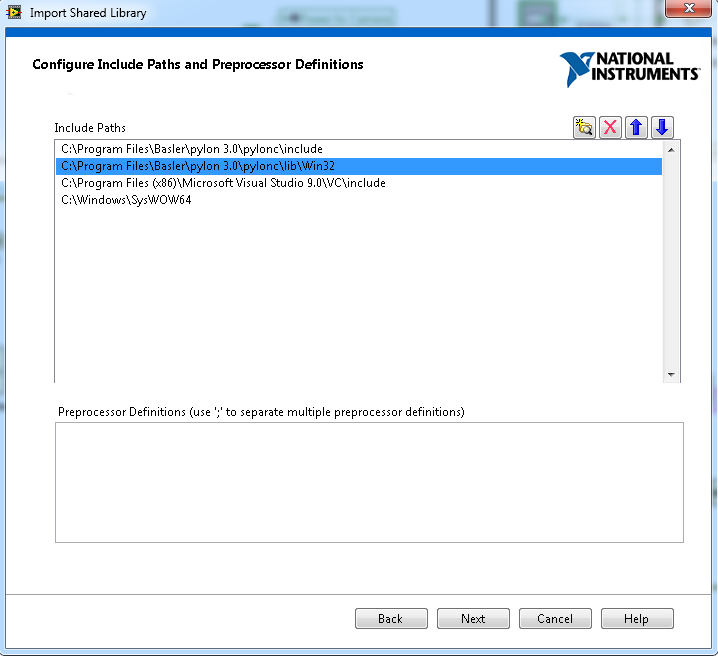

Undefined symbols can prevent the wizard from recognizing functions and parameters. To correct this problem, check the header file to determine if you must add preprocessor definitions. Click the Back button to return to the previous page of the wizard to add a preprocessor definitionsl (for example, "NIAPI_stdcall = __stdcall" or "NIAPIDefined = 1").
GENAPIC_EXPORTS;GENAPIC_LINUX_BUILD;GENAPIC_WIN_BUILD;MIDL_PASS;MRTDLL;PYLONC_BOOL_DEFINED;PYLONC_EXPORTS;RC_INVOKED;UNALIGNED;_CRTDBG_MAP_ALLOC;_CRT_ALIGN;_CRT_ALTERNATIVE_INLINES;_CRT_DISABLE_PERFCRIT_LOCKS;_CRT_FORCE_MANIFEST;_CRT_GETPUTWCHAR_NOINLINE;_CRT_MANAGED_HEAP_NO_DEPRECATE;_CRT_MANAGED_HEAP_NO_WARNINGS;_CRT_MANIFEST_DEBUG;_CRT_MANIFEST_INCONSISTENT;_CRT_MANIFEST_RETAIL;_CRT_NOFORCE_MANIFEST;_CRT_NONSTDC_DEPRECATE;_CRT_NONSTDC_NO_DEPRECATE;_CRT_NONSTDC_NO_WARNINGS;_CRT_NON_CONFORMING_SWPRINTFS;_CRT_OBSOLETE_NO_DEPRECATE;_CRT_OBSOLETE_NO_WARNINGS;_CRT_SECURE_CPP_OVERLOAD_SECURE_NAMES;_CRT_SECURE_CPP_OVERLOAD_STANDARD_NAMES;_CRT_SECURE_CPP_OVERLOAD_STANDARD_NAMES_COUNT;_CRT_SECURE_DEPRECATE_MEMORY;_CRT_SECURE_NO_DEPRECATE;_CRT_SECURE_NO_DEPRECATE_GLOBALS;_CRT_SECURE_NO_WARNINGS;_CRT_SECURE_NO_WARNINGS_GLOBALS;_CRT_SECURE_WARNINGS_MEMORY;_DEBUG;_DLL;_MSC_EXTENSIONS;_MSC_VER;_MSC_VER_GREATER_THEN_13102050;_MT;_M_AMD64;_M_CEE;_M_CEE_MIXED;_M_CEE_PURE;_M_IA64;_M_IX86;_PFT_SHOULD_CHECK_RETURN;_PFT_SHOULD_CHECK_RETURN_WAT;_PFT_VER;_POSIX_;_PREFAST_;_STATIC_CPPLIB;_TRUNCATE;_USE_32BIT_TIME_T;_USE_ATTRIBUTES_FOR_SAL;_VC_NODEFAULTLIB;_W64;_WIN32;_WIN64;_X86_;__BORLANDC__;__CRTDECL;__GNUC__;__cdecl;__cplusplus;__cplusplus_cli;__linux__;__midl;

you forgot to add the genapi include directory path in the second step. Your include file references this here:
#include <genapic/GenApiC.h>
And don't try to generate wrappers for DLLRegisterServer and DLLUnregisterServer.

I believe what rolfk meant was that you included "C:\Program Files\Basler\pylon 3.0\pylonc\include\" but not "C:\Program Files\Basler\pylon 3.0\pylonc\include\genapic\" and LabView probably does not check sub directories.

Well ok! But do any Pylon.. functions occur in the list in the second screenshot? For instance PylonEnumerateDevices()? Screenshots are nice but as you can see they often don't show much to do more in depth analysis. If these functions don't occur in the list you got the wrong DLL. If they do occur you have to analyze the rather convoluted preprocessor defines to find out which of them may be needed to let the parser see those function definitions.
And the error message is not complaining that GENAPIC_EXPORTS is missing, only that it couldn't find any function declarations in the header file that match any of the exported functions in the DLL and that this might be caused by the lack of a preprocessor define, listing all the conditional preprocessor defines it had encountered during the parse.

I gave up on using the dlls. I decided to use a completely different method. I am not using the api anymore, but rather, I am directly accessing the camera's registers. I had initially thought that using the dlls would be easier, but the direct register access wasnt too cumbersome. Working fine now.
