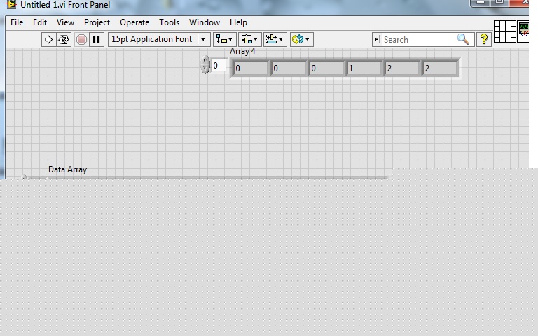

Message 18 of 39
(2,303 Views)
Message 19 of 39
(2,302 Views)
The screenshot above is how the array looks like after the first iteration.
When it should be (0,0,1,1,0,0)
Am I missing anything?
